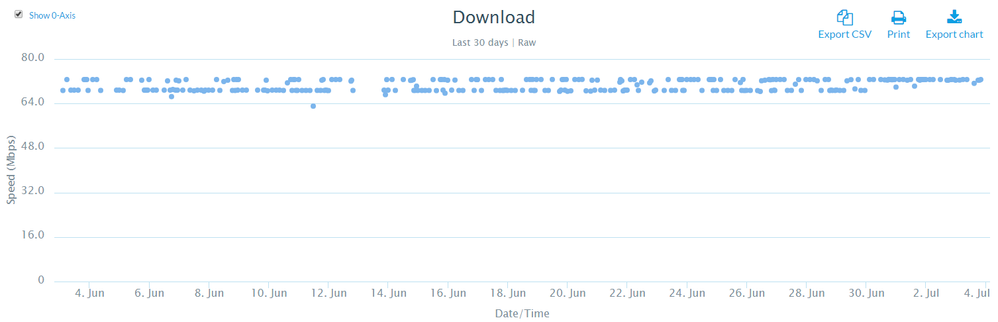

I've noticed a change in my "SamKnows" test results. Consequences certainly, but I think we're really "suffering" from the absence of something.
For background, @Oldjim noted the following:
@Oldjim wrote:
@bobpullen
speed tests - this goes back a few years where we discussed this at length and it was shown that effect of the Plusnet Current Line Speed was to add add a small slowdown to speed test results.
We compared the results where the Plusnet Profile was set higher/lower/equal than the BT IP Profile and - no  - I didn't really understand your explanation at the time
I have tested that too: When the "current line speed" was manually set to a "too-high" value, speedtests ran a little faster (by an extra 2-3Mbps on 80Mbps syncs) than when it was given a "correct" value. That was true of SamKnows results as well as Ookla's speedtest.net
Park that issue for a moment...
For the last few years, however, my SamKnows results have shown a strange artifact (and I've posted on here before about it): With an unchanging sync speed (80Mbps), I got downstream speed results of either 72.6Mbps or 68.7Mbps. Yes, there were occasional variations as something gets in the way, but the vast majority of tests are those precise values.
From the 30th June, the tests are now almost invariably just 72.6Mbps.
So I've lost the variation and the lower speed results, but the higher speed results aren't going any faster. And that is the "consequence" that is missing:
This suggests that the "current line speed" mechanism is still in place, and is still restricting speeds (by 2-3Mbps) to allow the prioritisation system to work ... but there is no longer a prioritisation system to make use of that space!
A full-speed FTTC line ought to give results of around 75 to 75.5Mbps.
Here's the raw results from the last month:
SamKnows Raw results, June-July 2017SamKnows Raw results, June-July 2017

Re: Plusnet Removes Broadband Internet Traffic Prioritisation
@Anonymous wrote:
We've been told for years by staff that it is an obsolete feature which is only relevant to legacy metered packages which have protocols (such as P2P and FTP) that were otherwise restricted during peak times,.  In addition we were told that the "Pro add-on" was irrelevant on the current unlimited packages (which don't have protocol shaping)
We were told that the "Pro addon" was an obsolete feature because the prioritisation mechanism is what made it obsolete. Now there is no prioritisation mechanism, the "Pro add-on" becomes viable as a potential solution for "something" on the current packages. What might that "something" be?
Probably nothing, but you never can be sure of all consequences of upgrading a live production system. If problems happen, it is always worth having the ability to rollback ... and, in this case, the "Pro add-on" allows for a rollback on an individual basis.
