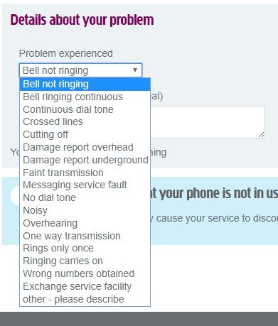

Performed a phone line test this evening (intermittent crackling) and was fairly impressed with the automated testing ... until I realised that the "this will take a while" message was going nowhere.  I then checked the BB connection only to find there was none.
After the connection was restored the test screen reported
Oops, something seems to have gone wrong
Indeed it did!  There is no evidence (visible to me) in my tickets that the test was run ... and failed as does happen with BB testing.
The phone line test advises users to not use the phone - it does not explicitly indicate that this is an intrusive test which will impact broadband operation.
Given that broadband operation is impacted then the test can never report completion successfully to the user.  May be there should be an instruction to run the test via a different connection - e.g. a mobile phone.
