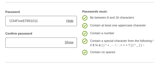

If I enter the signup process, then I am unable to enter a password that exceeds 16 chars in length. The field validation doesn't seem to permit it. If I attempt entering any more characters than what is seen below, then they are not copied to the screen: -
What web browser were you using and did you have your password manager automatically populate the password entry fields?
The reason your router did not automatically authenticate correctly is unrelated to the password you chose at signup. It actually looks like there was a delay associating the router you were shipped with your account (requisite for the router provisioning to work properly).
munchingfoo
Posts: 4
Thanks: 5
Registered: ‎14-04-2025
Re: Password requirements mismatch causes automatic configuration to fail
@bobpullen
Thanks for looking into this. Very interesting.
Brave Browser - latest patch at time of sign up (29 March 2025)
Keeper PWM corporate
Auto population through Keeper extension
