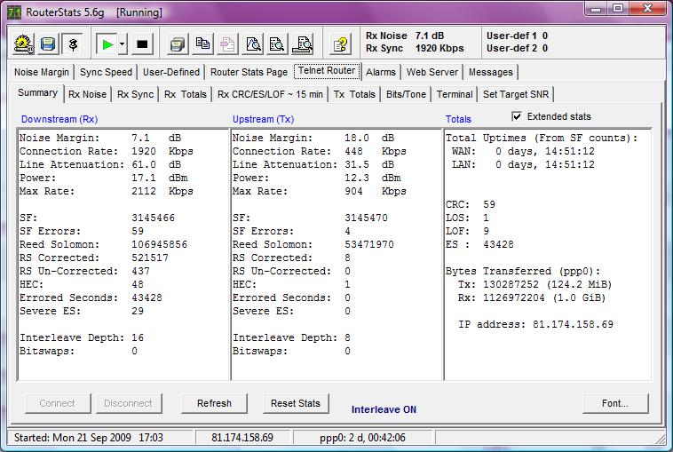

i would really like to stick with the ping atm but the dl im getting isnt good at all

What I'd like to see is that same page after being connected for an hour when your router is plugged in to the test socket inside the master socket. We need to make sure that there is nothing inside your house that is causing the errors.

ill post them up in abit
Re: PN is a rip off
19-09-2009 5:53 PM
error seconds are down massively
gonna have a play around
Re: PN is a rip off
20-09-2009 10:22 AM
Can you describe your telephone wiring, extensions etc and everything that's plugged in to a phone socket please.
Re: PN is a rip off
20-09-2009 12:47 PM
1 telephone plugged in the test socket with the router and thats it ive changed everything last time and got everything wireless.pulled out the sky pulled out the phone/fax
router normally goes in the other room as said the sync speed was better in there believe it or not lol
filter are on everything and ive got a i plate fitted
thinking maybe i should still leave interleaving off as the ping is around mid and rising then when it was on i was getting mid 40 and rising

ping is back to being rubbish high 40s and rising
dont know weather leaving the interleaving off was any better?
ill do some speed test and that as the web pages are taking awhile to load up

the error seconds are better
gaming wise is worse with interleaving on alot

Why not try a fixed 2Mbps line instead of MAX?
