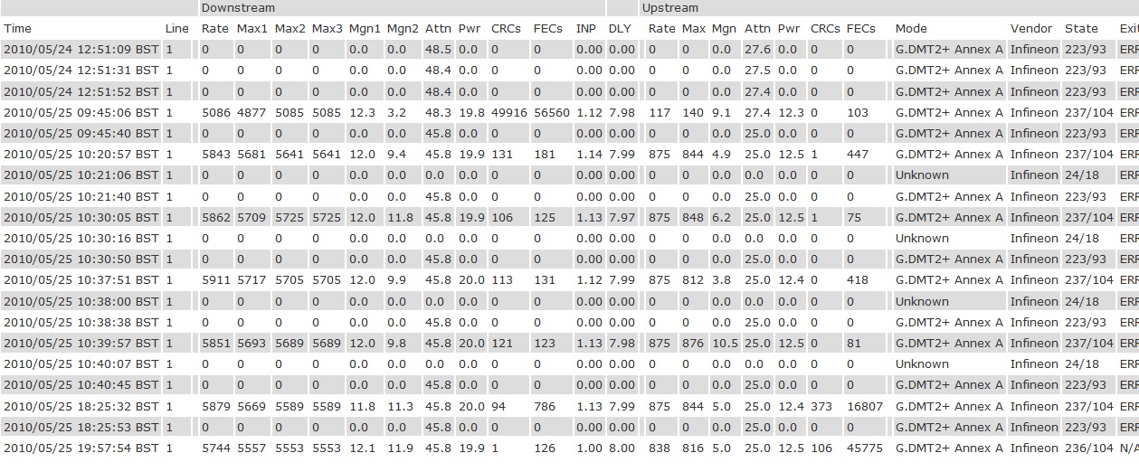

Thats interesting Adam, as a few weeks ago, your line tests pointed to a potential line issue, but BT didnt beleive us....  Out of interest, what are your line tests showing....
neither me or my wife are around tomorrow, but Thurs PM would be a good time, but what I really dont want is an engineer coming out, and doing all the same again, stating NFF, and going away.  I am not sure if a Hawk line quality test has ever been performed or not on my pair....

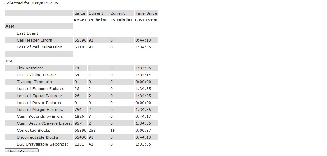

Just checked the Router stats, very interesting.....  They are posted below.  At what time did you do the line tests, as everything seemed to stabalise around 09:45 this AM, and as yoiu can see the attn came back to a normal level for my line, and upstream back to a sensible level.  This absolutely stinks of a line fault, as a line test sends voltage down the line, and so will clear any areas of bad connection, corrosion.  The ticket states BT seem to think there is an issue with the line from the Cab to the house.  Can we request them replacing this section of line, rather than just pair swapping.  If not, can we force them to do a pair quality test on the new pair...... This must be costing them a small fortune, surely putting in a new section of copper must be cheaper....
