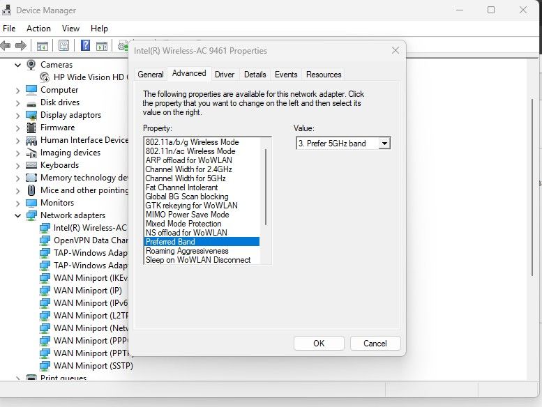

I suspect your PC is switching between 2.4 and 5GHz wifi signal and it is that causing the variations of speed.
Try changing the wifi adapter on the PC to Prefer to use 5GHz to see if this helps.
Device manager is where the setting is found (Windows key +X then M)
