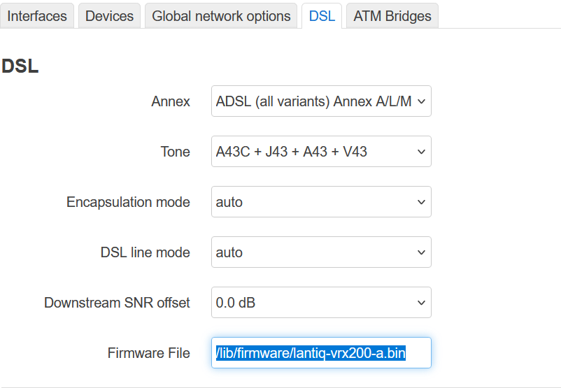

Anyway I had a look at the dsl tab in LUCI and noticed there was nothing in the firmware file box
So I looked where the firmware was and added the file
then ran start & status again, this time it reported running
root@OpenWrt:~# /etc/init.d/dsl_control start
root@OpenWrt:~# /etc/init.d/dsl_control status
running

I added the firmware file entry to the DSL menu and /etc/init.d/dsl_control is now working 🙂
