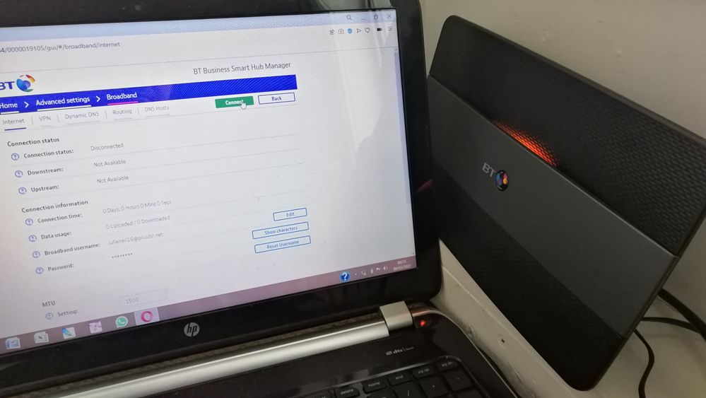

Help. New to the community.
Just bought a new bt smarthub 6 ( business ).
I have followed all your comprehensive instructions( thanks), but cannot for the life of me get in to connect.
I have managed to reset, and input new user and password. When I click on the green connect button. nothing happens. Have tried plugging dsl cable in at various times in the process but still cant connect. Have attached image to show.
Am I missing something in the instructions? very frustrating.

@nmart  Welcome to the forum.
Your ‘attached image’ is missing.
If you switch the hub off then back on are your Plusnet credentials being retained or does it revert to the default BT ones?
Have you read this further update? https://community.plus.net/t5/My-Router/Using-A-BT-Smarthub-An-Update/m-p/1795292#M24601

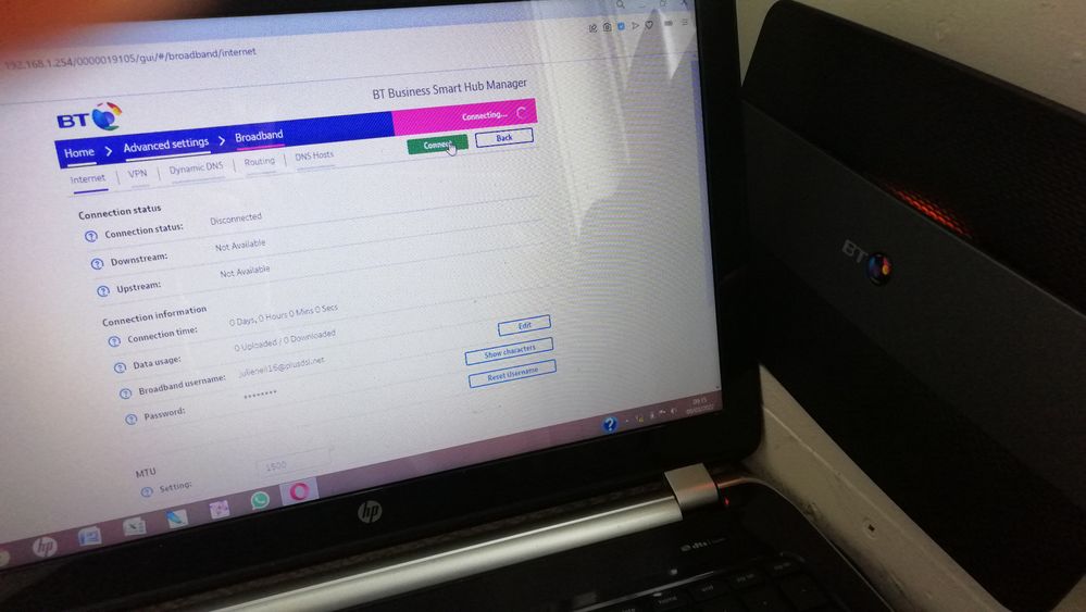

Hi, Thanks for reply.
Apparently I cant attach any images yet as Im a newbie.
Yes the router has retained my plusnet credentials. It didnt initially and took a few attempts.
When I click on the connect button, the pink ' connecting' progress box appears. It tries for a few minutes then reverts back to green connect button. I have tried plugging the dsl cable in at various times after clicking the connect button ( and even before). Should the router prompt you to plug cable in?
Would appreciate any advice.
Posts: 14,892
Thanks: 7,778
Fixes: 480
You should be aware that this is a bodge to get a BT hub to work with Plusnet so there is no prompt as it connects automatically for BT customers. The fact that it tries to connect suggests that the username is correct. Have you checked your password by using it to connect to your Plusnet account? Have you checked that it doesn't contain a special character as per the link in my last post? If necessary change it to just letters and numbers and try again.

Hi, Yes understand it is a workaround.
Username and password works fine on plusnet hub one. password is just letters all lower case, so nothing unusual.
when I click connect, router is flashing purple, then flashing orange once dsle is plugged in. Then reverts to solid orange.
managed to sttach images no. thanks.IMG_20220309_091546.jpgIMG_20220309_091535.jpgIMG_20220311_115341.jpgIMG_20220311_115331.jpg
