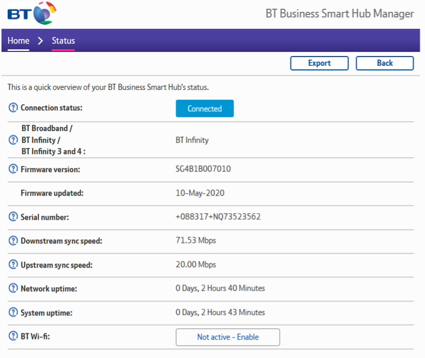

HI @Baldrick1
Thanks for the info my BT Business Smart Hub is working on Plusnet.  However can you (or anyone of course) advise - is a Business Hub?   That's what I *thought* I'd bought but the screenshot shows different title and firmware to others on this thread.

kaash
Posts: 9
Registered: ‎16-04-2020
Its business hub, and firmware had been updated just a week ago so that's why it might be diffrent.

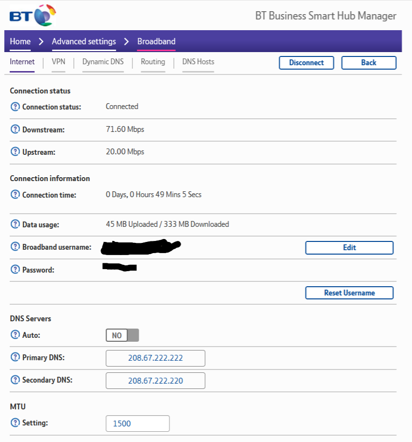

@demsley  Welcome to the forum.
Model 084316, which this is, is a residential version of the Smarthub 6.
Edit
Two big give aways is the header and if you go to the Advanced Settings/Broadband page you will find the option for setting your DNS servers
demsley
Posts: 3
Registered: ‎09-05-2020
Thank you for confirming this.  Back to the eBay vendor I go!

Posts: 14,836
Thanks: 7,733
Fixes: 480
@cancunia
As far as I am aware there has been one claim that you cannot turn off BT Wifi. I have had experience of setting up two previously with no such a problem.
For information I have just bought a brand new FTTP Business Smarthub to assess it's capability. Watch this space for my thoughts on this but to give you.a start.
1. As expected this works fine on a Plusnet FTTC service, you just lose the use of one LAN port.
2. It did not update.the firmware when I first switched it on yesterday.
3. When first switched on BT WiFi was switched off. This automatically switched on overnight. I assume that this is the default setting and does come with a warning that it can take 24 hours to activate should you want it.. All I had to do iwas select it this morning, enter the admin password and when I checked a couple of minutes later it had switched off.
4. To see if I could trigger a firmware update I dropped the DSL connection then switched it off using the on/off switch on the hub. On switching back on and reconnecting it immediately picked up new firmware.
5. BT WiFi remained off. I shall monitor this carefully and report back if there are any changes.

Posts: 14,836
Thanks: 7,733
Fixes: 480
I note that I can no longer reply to this thread https://community.plus.net/t5/My-Router/Using-a-FTTP-Smarthub-6-on-a-Plusnet-FTTC-Service/m-p/165176... so i will add it here.
I have now played a little more with a Business version of a FTTP Smarthub 6, a model 088317. This behaves exactly the same as the residential FTTP Smarthub 6 as reported in the above link. The firmware is the same for both the Business and Residential models, currently SG4B1B0092BE
Connecting it directly via the DSL link gives you exactly the same facilities as the residential version such as ability to set your own choice of DNS server, control over SIP ALG etc. However, you lose one LAN port.
Connecting it using an unlocked modem (I have a redundant Huawei HG612) plugged into the WAN socket enables all the data available via 'telnetting' the HG 612 to be extracted, I use DSLstats. All the other Business features still work. Now you also need one of the LAN ports to extract data from the modem, leaving just two.
So my conclusions are:
1. These are potentially a good buy as there is potentially less demand for them, providing of course that you don't mind losing a LAN port, two if you are using an unlocked modem for monitoring.
2. They are potentially very useful if you have any connection problems as all you need to do is remove the DSL line, swap the DSL cable to an unlocked modem and connect the modem to the WAN and LAN socket and you can fully monitor the DSL connection without affecting any other settings.
I shall probably use it in the single unit mode and keep the modem in a cupboard in case I have any connection issues.
For those who are interested ,all these changes have not affected my switching off of BT WiFi, it steadfastly remains off. Neither does it have any FON output.
