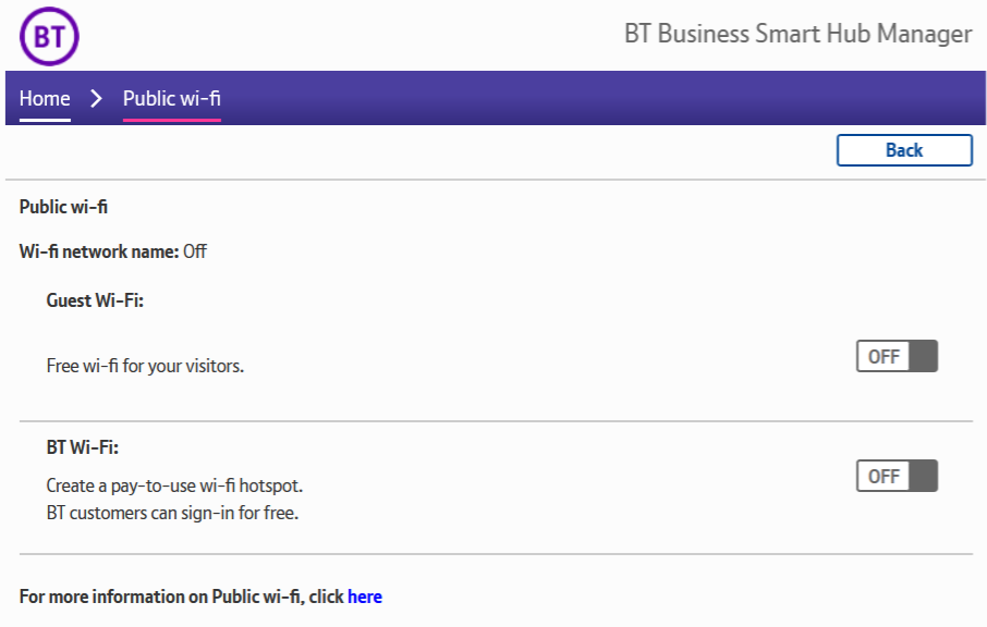

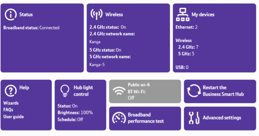

I have just looked at mine in a bit more detail.
I am on the same firmware.
I have the same greyed out home page:
But if I click on it I can enter my admin password and appear to have full control, I have not tried it just in case!
Have you tried this?
kaash
Posts: 9
Registered: ‎16-04-2020
Thanks for reply for some reasons I cannot change anything, I entered there after admin password. I think you are lucky, might factory reset again and see if that does any trick.
