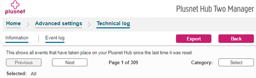

I have the same expectations as you, next time it fails post an exported copy of the event log on this thread, hopefully it might point to what problem you are getting.
You'll find the log file here
You'll need the administrator password to be able to export them
