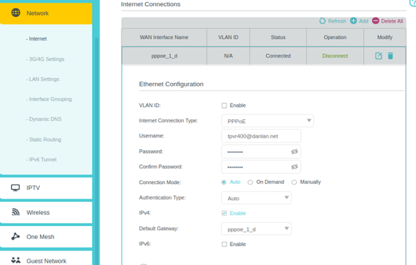

Is the TP-Link AC1600 a VR600?
You need to go into advanced setting and change the mode to Wireless Router Mode.
Then select Network >Internet >then select modify, hopefully you'll get a screen something like
Username will be <yourusername>@plusdsl.net and password used for the members centre, do not select VLAN as the ONT looks after that
LAN4 port becomes the WAN port, connect the WAN port to the ONT.
HTH

I use the Unifi as my wifi points due to the sizeof the area I have a few of them to give good coverage @Dan_the_Van thank you very much for your help have got it all set up and working on the tp link router new I was missing something simple thanks

It was using the wireless router mode to let me use the login setting I needed that you pointed out in your last post yes, that is what I did not like about it, I like to static IP a few things my nas my two main computers and my printer and wifi units
