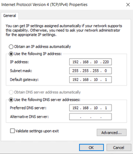

2) Windows 10 PC - Using a wired connection. In Network Properties it is possible to give a device two IP address.
Windows Key + R In the run box type ncpa.cpl and click OK. Then double click the icon associated with your network connection. Then Properties >Internet Protocol Version 4 (TCP/IPv4). >Properties. You will see.
You need to select 'Use the following IP Address' and enter you choice for you LAN, then click on Advanced

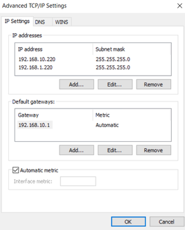

Here add your choice of IP Address for the 192.168.1.0 network. Click the OK and close to leave the GUI.
Once either the above steps are completed you can connect one of the Hub Two LAN ports to your home network LAN.

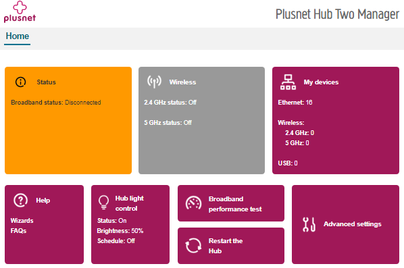

You can not enter http://192.168.1.254 in your browser, being in Bridge Mode most of options are unavailable.

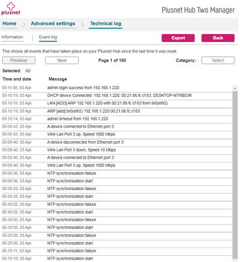

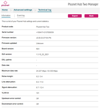

Advanced Settings > Technical Log
You can select various log categories as required
