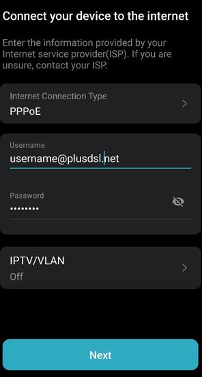

Posts: 5,022
Thanks: 3,321
Re: Trying to use a different router!
@timbo49
Hopefully the procedure is the same as my TP-Link router. I would image your mobile device is selecting the Hub two as it has previously used it.
Before using the tether app turn the Hub Two OFF. I would reset the TP-Link and start again.
On the mobile device you should be able to connect to the BE3600 default WiFi. make sure the WAN port is connected to the ONT.
If I recall, on first switch on and connected to the BE3600 WiFi it prompts you setup a admin password.
->More --> Quick Setup is where I would configure the PPPoE connection
Next takes you to the WiFi setup screen, here you could change the defaults to match the Hub Two.
