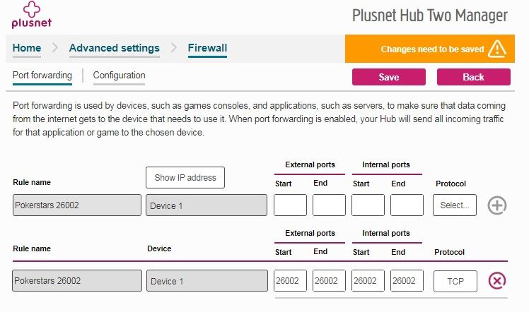

OK thanks it is a Pokerstars application and I am having problems with packet loss at the router. I am using a Plusnet Hub Two I think but will need to check. This is what was diagnosed by the tech team at Pokerstars. It happened in playing and starting a certain number of tables, but then I would be locked out of some of them. Shutting down and re-starting the client was not enough to sit at the missing table.
I found access to the router adiministration page and settings, but I couldn't see how to translate the information given to me by Pokerstars into the router.
The screenshot would hopefully show the check boxes where I should try and input the info from Pokerstars.

You would need to click the 'Create a new port forwarding rule' button, enter details as below, click the '+' icon next to the form fields and then click 'Save' top-right to commit the changes. Where it says 'Device 1' you would need to select the device the Pokerstars app is running on.
You need to repeat this process for each of the ports, i.e. follow the same steps again but use '80' and '22' instead of '26002'.
However...
This strikes me as bonkers if I'm honest. What this is effectively doing is carte blanche exposing the device the application is running on to *all* devices out on the Internet. Ports 80 and 22 are typically used to host web servers or SSH servers so often get a *lot* of attention from ne'er-do-wellers out on the Internet searching for systems to compromise.
Quite why a Poker client would need to have these ports exposed like this is beyond me. I can tell from your screenshot that you have uPNP enabled and that should be sufficient (if even that is required).
Another way you could go about this (and I would only recommend it as a temporary measure) would be to put the device running the application into your 'DMZ'. This is also acheived via the Firewall menu, under 'Configuration': -
What this does, is pretty much forward any and all external traffic to the device running the Pokerstars app, irrespective of ports. If these missing port translations are indeed the cause of your problem, then putting the device in the DMZ provides a very quick way to check to see if the solution you have been given will work.
I remain highly sceptical though ![]()
