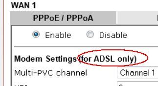

Hi all, I got a new modem as I've been having issues with the Plusnet One router which comes supplied by Plusnet. I've been trying to configure the new modem with the correct settings to get my superfast fibre working - I think I've got the settings right and can access the internet, but the speeds are on the slow side - this might be because Openreach have just been in and done work at the local cabinet and so my connecting is trying to stabilise.
In particular, I noticed I could only select PPPOA, not PPPOE when configuring the connection. My guaranteed minimum speed is meant to be 56mbps, but right now I'm closer to 47-50mbps. Based on some speed tests that were done before switching routers earlier that day, the speeds do seem comparable.
Have I got the settings right and just need to be patient to let the line stabilise or is there some other issue?

The default 6dB noise margin reported by the Draytek for downstream, suggests all is OK.
Why not plug old Hub One in to see if there is any change in speed and the downstream noise margin?
The Settings page indicates the 'Modem Settings' are for ADSL only.   It does not apply to VDSL connections.   PPPoA is only applicable to ADSL connections.  As you have internet access, I wouldn't worry about it.
By enabling PPPoE/PPPoA, the Draytek knows to use PPPoE on the VDSL superfast broadband connection.

Thanks for clearing the settings up - that helps!

Having said that, your screenshots look OK and are similar to my Draytek 2860 setup.
