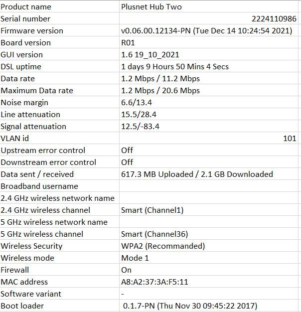

BT Broadband(obscuring your phone number) and BTW Performance Tester - Over a wired (ethernet) connection if at all possible, please report the 'ADDITIONAL DIAGNOSTICS', and sight of the broadband connection status from your Hub (with the 'Username' obscured) would be a good starting point.

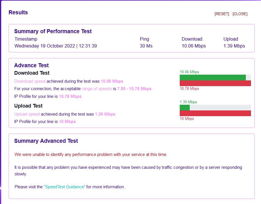

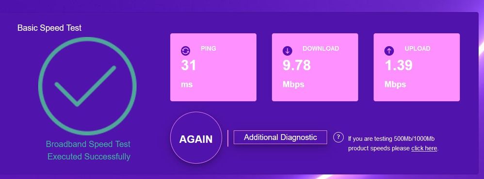

Thanks for your assistance. There was no noise on the quiet line test. Diagnostics as requested:

Thanks for that data. Taking them in order: You are clearly a long way from the FTTC cabinet, and therefore have a very long copper run, which doesn't help at all. Your speed test, if run over an Ethernet connection, is a little low, but that could well be due to the elevated downstream SNR figure, which is way too high, and indicates  a problem in the network somewhere - most likely upstream of your master socket. I assume the short DSL uptime is due to the testing?
The BTW test indicates that you are only getting around 12Mb to the test socket.
Could you please run the speed test again, but this time, report the results of the 'Additional Diagnostic'?

As requested:

SNR - Signal to Noise Ratio - 'Noise Margin' on your Hub Help Desk screenshot.
