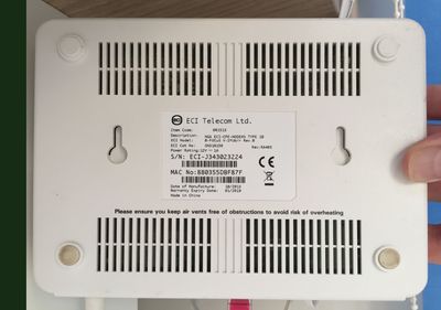

About 8-10 years ago we went FTTC and PN came out and installed a modem (I think) and a router. Three years ago I replaced the PN router with a Netgear Orbi mesh system and a couple of satellites and it has worked really well. I'm not an expert but because recently I have to keep restarting the router and the modem regularly for signal loss, I'm wondering if the PN modem needs replacing. I can't find an IP address for this although the Orbi in its connected devices settings does not show the modem.
If that is the case is there any setting up to do with a new modem? When I installed the Orbi I entered the fibre Username and Password but does the modem also require any special setting up or is it plug and play?

All electronics fails eventually but don’t assume that this is the cause of your problem. It can be decades.
There aren’t that many manufacturers of modems these days as most of the world has moved on to FTTP, leaving the UK in the last century as far as the Internet is concerned.
If you want to try a different modem to see if that’s the cause of your issues then get a Huawei Model 3B HG612 from an auction site. These are plug and play, directly compatible and better than the ECI version that you have. Unless you want to look at your line stats you do not need an unlocked one.
As a modem communicating with the router over the WAN port it does not have a local network IP address

As an update to your recommendation Balders, I have ordered the modem you linked. Found a new one on eBay. This morning as usual, no internet. I restarted the Orbi router and that showed no connection after, so I restarted the modem and that fixed it. Does that absolutely point to the modem or could the fault still be elsewhere?
I don't know the first thing on how to check anything else or where to go, so any advice on that would be much appreciated. Do I contact PS and get them to check the line?
Thanks to all.

Well, I haven't done a factory reset. It's worked well for about 2 or 3 years. It was set up successfully as mentioned in your link. It just to drops out occasionally, often in the morning first thing. Openreach recently moved the outside fixing point from our neighbours house to above my garage ( seen here), so whether this has anything to do with it, I don't know. My gut feeling is it's not the Orbi. The Netgear Orbi app is pretty extensive with its features giving lots of information of what happening on the network. The Orbi IP interface showed it was working okay but no internet was incoming to it. Once the modem was restarted this morning, that fixed it. I'll have the new modem you recommended early next week, so I'll connect that and see how we go.
(I'm aware btw that the plate shown here is not affixed properly to the wall).
