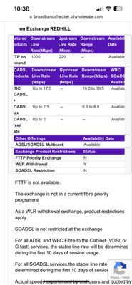

To answer a previous questions: I am on ADSL, looks like fibre is not available in my flat.

@tudorradulescu Looking at that BTw report, you appear to be restricted to ADSL only, which is a little strange, as I know a couple of people on that exchange who can get FTTC, although I do understand that they too are currently unable to get FTTP from OpenReach.
Unfortunately, the snippet of the error log you have provided does not give any useful information.

  1. Do you know whether your broadband is ADSL or FTTC ?
    I have ADSL, have attached BT report in a reply earlier. Looks like there is no other option available.

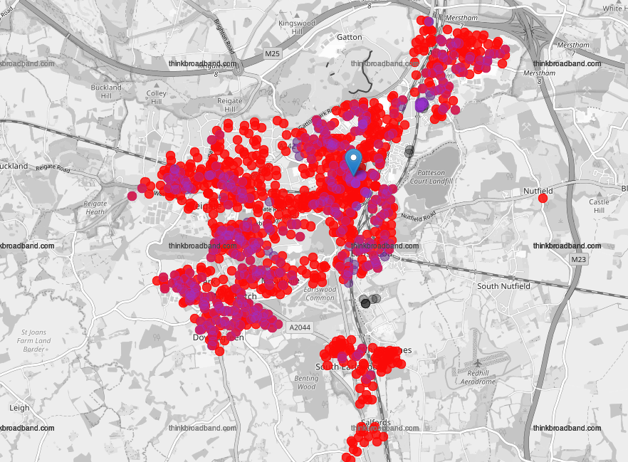

As Openreach don't serve you with anything better than SOADSL, here is a map of where AltNets serve the Redhill area -
If you are located in the areas covered by coloured dots, then you might be able to get full fibre broadband from -
Check all the above links to see what alternatives to ADSL are available to you,
otherwise you'll be stuck being forced into moving to an ISP that supports SOADSL, some of which I've listed here,
or investigate whether you can replace your landline broadband with a mobile 4G/5G router on a data plan.

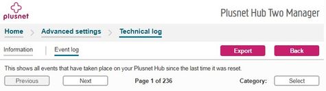

From the Home page navigate >Advanced Settings >Technical Log >Event log. In this instance do not change the category
Click on Export this will download the event.log to the download folder, attach to a post using the paperclip found below above File attachment limits.
