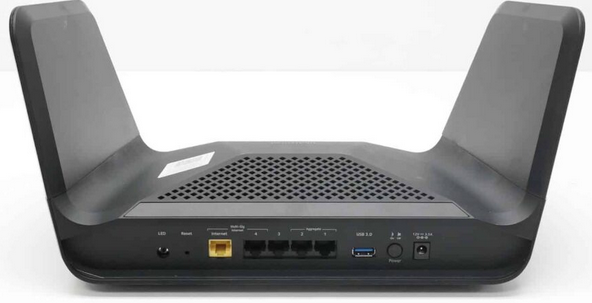

Have you tried doing a FACTORY RESET by inserting a paperclip in the 'Reset' hole on the back
Typically the device should be powered on and the reset button held for at least ten second.

Can you get in using a computer connected with an ethernet cable,
then in a web browser navigating to  http://192.168.1.1  or  http://www.routerlogin.com
