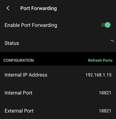

You don't need to use a VPN, you can use port forwarding as explained in the help article. Arlo simply recommend using the VPN route as exposing ports to the Internet can be considered a security risk.
The ports and IP address you need to use for the port forwarding rule are shown when enabling the functionality in the Arlo app: -

Re: Port forwarding using Plusnet hub 2 for Arlo cctv
Brilliant!  Thank you. Went into the Arlo app which had a port forwarding section to enable and then gave me the IP address to use along with the Port numbers.  It now works. So again many thanks
