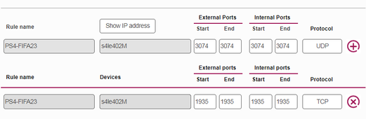

Hi @Gringo1 welcome to the forum.
My my research you need these rules, is this the same as you have found?
To add a port forward rule, from the Firewall section of the Hub Two click on "Create a new port forwarding rule"
The name needs to be unique, I would suggest PS4-FIFA23, I have created a few examples of what's require, hope it makes sense?
Use the device name rather than the IP Address.
Add the necessary data into the fields and click on + to create the new rule.
Rule with a range of ports
Click on + to add the rule each time you add more port/s  When you've finished click on save.
I've only created a couple of examples.
HTH

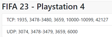

This is what I'm using for my PS5, should be the same as it's for PSN.

Hi Dan, thank you so much for this. I've played a few games now and things definitely seemed to have improved. I really appreciate your help.
