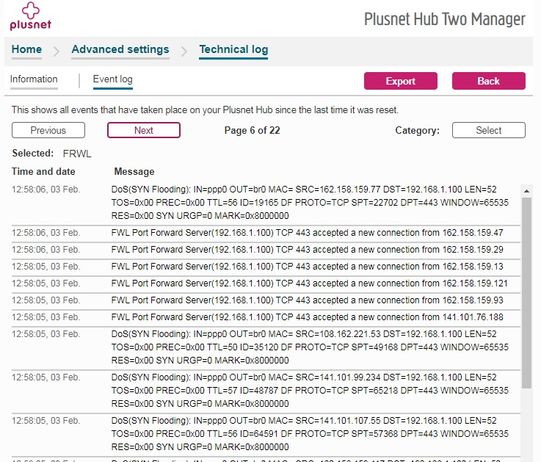

Got my new Plusnet Hub 2 and the event log seems somewhat limited compared to the hub 1,
Certain selections show nothing - for example, If I click 'firewall' filter it just defaults to the 'All' view so I have no idea if my firewall is actually blocking anything or letting everything through or is even on!
Is this how it should be?
Firmware version: v0.05.03.07154-PN

I don't see that here. Whilst certain categories might not be particulalry verbose, I do see entries under the FRWL category ![]()
