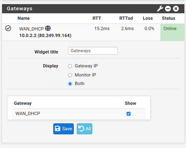

Following @Anonymous instructions you can add a device IP which responds to ping, he using a plusnet DNS IP, I am using
pingbox1.thinkbroadband.com [80.249.99.164] a device which off plusnet network.
If you click on settings for Gateways you can change the displayed IP, I have chosen both.
HTH
