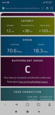

Left image is my Poco F1 right image is my partners A71
Poco F1Poco F1Samsung A71Samsung A71

Those bufferboat results are interesting.
There is almost no difference between the phones,
your broadband is working well,
and the large latency on the upload shows that you need a QoS capable router to eliminate the ping spikes
