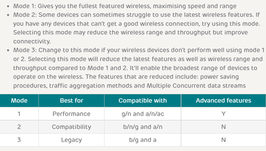

There have been a few ports recently regarding some devices not being able to connect to a Hub Two using wireless
Within the settings of the Hub Two wireless network is the ability to change the mode, the default being Mode 1.
A suggestion would be try setting Wireless mode to 'Mode 2', see below.
If Mode 2 doesn't work try Mode 3, if then connects try Mode 1 again.
Can you please feedback your results as they will be helpful for others

Thank you very much for your suggestions, and for explaining them so clearly.Unfortunately, I've tried all 3 modes, including disabling the 5ghz thing temporarily within each mode. No success at all. I'm obviously missing something, probably really simple. Off to explore whether I can go back to BT! Thanks again
