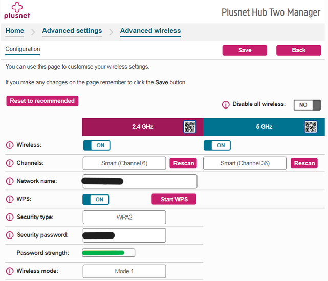

Posts: 5,002
Thanks: 3,309
Re: New FTTP with variable speed
@Bamboozled
Best performed on a desktop PC.
Click on this link http://192.168.1.254  and navigate to ->Advanced settings -->Wireless
A Rescan may select another channel or if you click on the box in my example Smart (Channel 6) you can manually select 1, 6 or 11, using a different channel to that being displayed.
There is an event log which might detail what happening with your wifi
->Advanced settings -->Technical log ---> Event log - select Category 'WIFI' export and attach the file to a post using the paper clip below the post window.
@Dan_the_Van
Hi Dan .... many thanks again for your reply. Ive been dragged here and there since my last reply and coupled to the fact that my Wife was not "reporting" to me as often I delayed looking at your "fix"
I opened it with fear - fear of messing up that is. Had it been "turn off Router or OTP box and leave for 30 minutes " I would have done it by now probably lol
But I gave it a look at and have a couple of (very simple I expect Questions) and will be glad of your reply .
1 ) I didnt know the number to enter when I first opened the Link. Is it a generic 0000 or 1234 or similar. Cant think I would have changed anything
2 ) Do I actually click in the Box where it says Channel 6. I presume yes and expect there will be a drop down showing the options
3 ) If I have got this far do I also need to do something similar with the Box that is showing Channel 36 in your example
Sorry if you are now laughing so much your ribs are aching ... but I do know that little !
