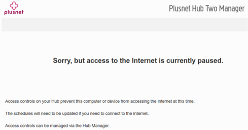

Posts: 5,006
Thanks: 3,315
Re: My router was reset by someone else
@JMak
It is possible to pause a devices access to the internet.
Go to Advanced settings >Access control >Pause
In the devices list select the device that is unknown to you, select the time period you wish to pause it. It can be paused for 1 or 2  hours or a custom period.
The device will see this message when using a browser
