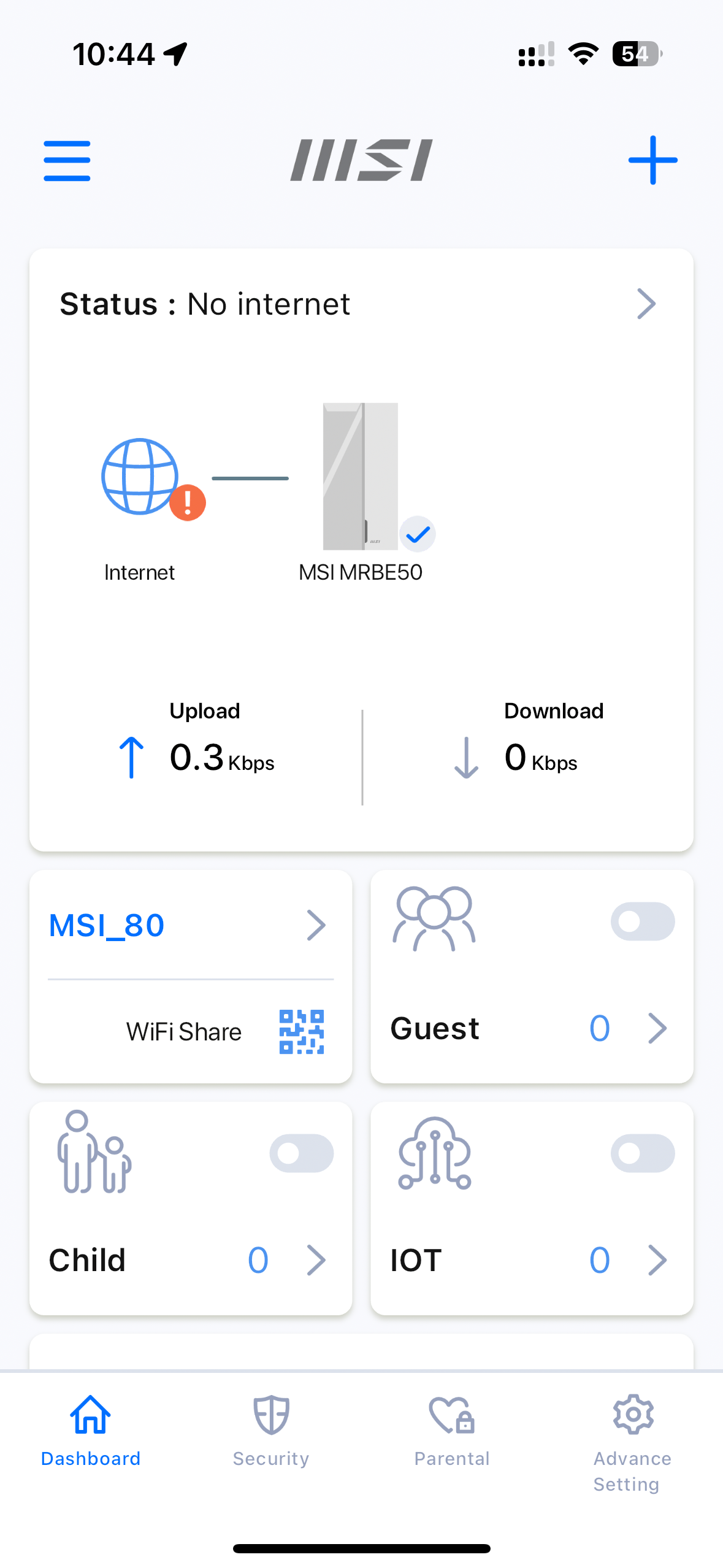

jamaldcw
Posts: 5
Registered: ‎20-12-2024
Re: Issue w/ Mesh Router Setup
@Mustrum I will try turning the WiFi off of the HUB with a DHCP setup and see if that gives me any results --- I've been configuring the network with PPPoE every attempt so far. There's no explicit error feedback. The modem pulses orange, indicating "No internet," that's about it.
Images are attached for some reference.
jamaldcw
Posts: 5
@Mustrum Thank you for the assistance; this seemed to be the solution I needed.
It seems interesting, considering all of the guidance for mesh networks centering around Bridge mode, PPPoE, VLAN, etc., for this to end up being a regular plug-and-play DHCP setup like typical broadband modem & router setups are.
Anyway, I appreciate the help.
