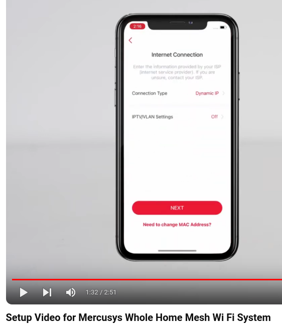

Assuming that this is what you've got - https://www.mercusys.com/uk/product/details/halo-h30g/v1/3-pack/
Watching the setup video on that page - YouTube : Setup Video for Mercusys Whole Home Mesh Wi Fi System
using the phone app, when you get to video timestamp 1:32, you'd need to change the "Connection Type" from "Dynamic IP" to PPPoE, and presumably it would then prompt you for your Plusnet Username+Password in the format described by @MisterW
Screenshot 2024-06-21 at 16-23-49 Setup Video for Mercusys Whole Home Mesh Wi Fi System.png
