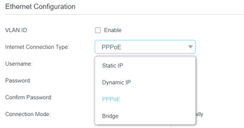

My TP-Link has these options
If this option does not exist then you need to buy a router which supports it.
