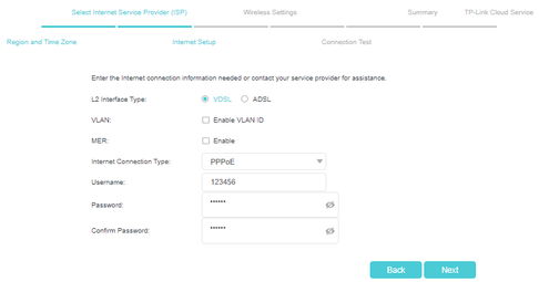

Well, it would appear from the manual that it could work, but actually getting it to work is another matter
Unless you have any special settings I suggest you reset the VR900 and start from the factory default
Connect to the VR900 front end, after you have setup your choice of password, Select Quick Setup, select your time zone settings, when you get the option to select your ISP select other, then next. You should see this
Setup the required fields
HTH
Edit: posted a bit late with fix suggestion
