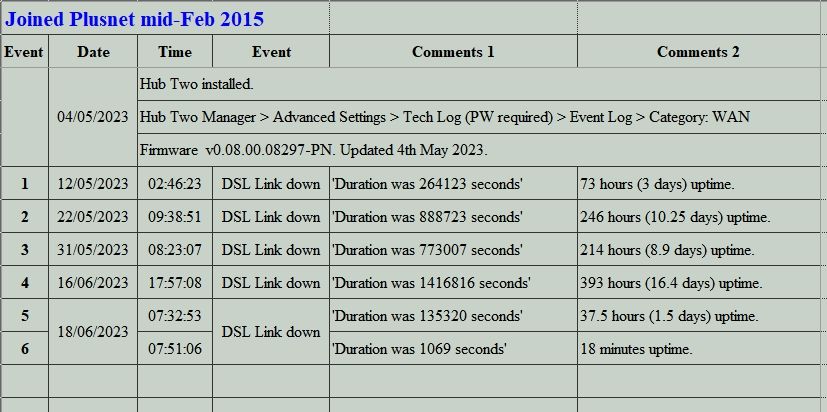

Yes there were 2 'DSL link down' events this morning. Don't know why. The hub showed orange before turning blue again.
At this point not too much of a problem but time inbetween dropouts seems to be reducing. See photo.

Posts: 4,962
Thanks: 3,256
Fixes: 147
Re: Hub Two Manager Event Log Filtering doesn’t work sometimes
Although you've had a few DSL link down recently, they may not be regular enough for investigation yet. Some folk may disagree.
For a reliable broadband band connection you require a noise free phone line, to test for noise dial 17070 and select option 2 quiet line test once prompted. This test is best performed in the test socket using a corded phone.
I have found in the past the Openreach Master Socket 5C with a MK4 faceplate can introduce noise to the line due to poor seating. Reseating the faceplate can resolve the issue.
If the connection become more regular I'd raise a fault.
