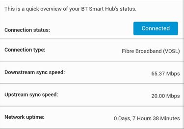

Re: Hub One - 5GHz WiFi issue
Hi @calorian
Early days yet, but here's the connection rates which I am more than happy with.
As for the firmware update, i didn't do anything - by the time i got to view/rename my connected devices I noticed the firmware had been updated.
