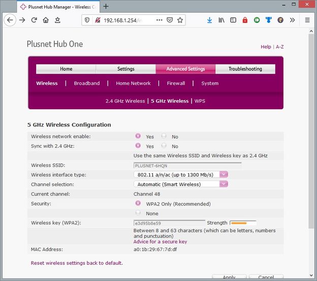

@Surfer You will need to separate the 2.4 and 5GHz networks in the advanced setting tab, rename one or both of the networks & you can then choose which one to connect to on each individual device.
Under the advanced settings tab, choose 'Wireless', then select the 5Ghz network and choose 'no' under 'Sync with 2.4GHz'. This will then allow you to rename the SSID separately from the 2.4. (I just put "-5" after mine), then click apply. You should then be able to select your preferred network on your device & Password will remain the same for both - unless you want to change this also.
Hope this helps.

Being a bit of a noob I have no idea how to select 5Ghz on the device like the LG TV?

@Surfer in it's default configuration (2.4GHz and 5GHz 'merged') the decision as to which channels to use will be taken by your device e.g. the LG TV.
It is important to remember that whilst 5GHz is faster/less susceptible to interference, it is also shorter range. If one of your Firesticks and the LG TV are further away than the Firestick that's already on the 5GHz network, then they may be connecting to a 2.4GHz channel because they deem it more reliable.

@Kateh wrote:
Is there an update on this? The screen is no longer the same & I need to change from 5 to 2.4 to allow a pet monitor to continue to function.
Not sure what you're asking here? If you need to specify which of the two wireless networks a device connects to then you may need to consider giving them different network names. To do this, you need to navigate to the page below, select 'no' next to 'sync with 2.4GHz', ensure the 'Wireless SSID' has a different name to the 2.4GHz network and then apply the changes. You should then see two wireless networks when your devices scan for available hotspots and you can choose which you connect to.
