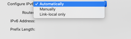

@Mook Thank you for the suggestion!
I have not — I've got 3 options, none of which let's me de-activate it.
Configure IPv6: Automatically ( current but problematic setting ? ), Manually, or Link-local only
Shall I try the Manual option with the Hub's IP address?

The best option @annamariamuller is to use a Terminal :
Applications > Utilities Folder > Terminal
Then enter:
sudo networksetup -listallnetworkservices
For example:
Mook@iMac ~ % sudo networksetup -listallnetworkservices
Password:
An asterisk (*) denotes that a network service is disabled.
Ethernet
USB ACM
USB Controls
Display Ethernet
LAN-2
Display FireWire
Wi-Fi
Bluetooth PAN
Thunderbolt Bridge
Mook@iMac ~ %
Then from the list above use :
sudo networksetup -setv6off INTERFACE
Where INTERFACE is a name from the list above: e.g. Ethernet or WiFi

Thank you much, @Mook , that didn't work either. I'm now pretty convinced it may be a hardware failure and I'll have to go down the iFix It Airport Board replacement route…
Thank you so much for this additional suggestion to try!
