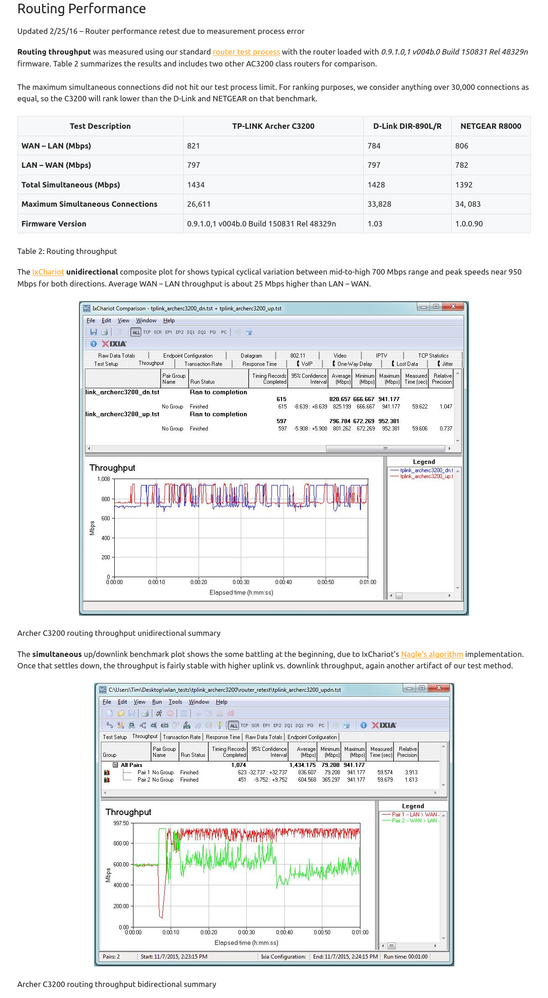

From this review and test - TP-LINK Archer C3200 AC3200 Wireless Tri-Band Gigabit Router Reviewed
here are their WAN <--> LAN  throughput test results -
EDIT: I've attached the above image below, if it helps your image viewer to zoom to a readable scaling !.

@Anunnaki thanks for that. That would tend to confirm that the TPlink firmware has the proprietary module.
Note that the test process explicitly states QoS disabled.
