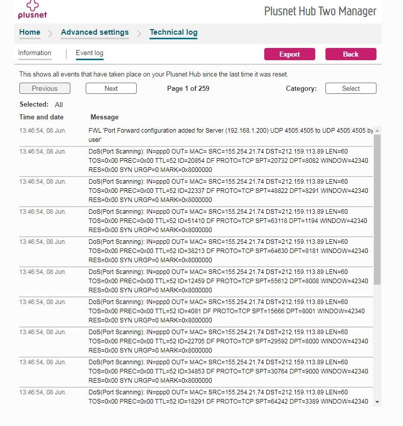

@Dan_the_Van I'm afraid I didnt really understand what you said, but I changed the 4050 to UDP then checked the technical log and I get this. Does it tell you anything useful?

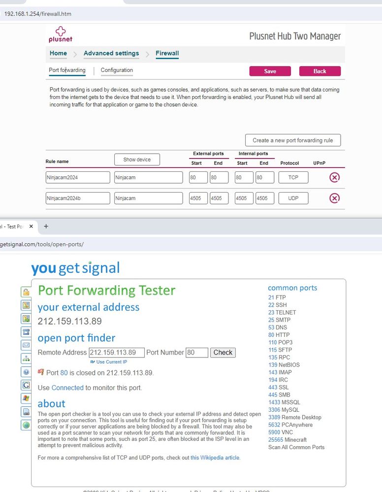

So I get that I may have other issues, but definitely appears port 80 not open so thats a definite obstacle.   can anyone see what I'm doing wrong?

port4050 also showing closed.
here's the "config" settings for port forwarding.  If anyone can spot what I'm doing wrong much obliged.  If any of your can recommend some sort of paid servi9ce to get this working for me I'd be interested.   Really need this up and working for piece of mind.

@salcalvert i think you might struggle to forward port 80 since its the internal gui port.
Try forwarding external port 8080 to port 80 on the internal device. Then use <accountname>.plus.com:8080 when trying to connect
Your static IP looks correct.

Its worked for port 80 for years on my other router but ok I tried this no difference.
Also not clear on what you mean by internal device.
and thirdly, connecting from the phone app using static ip only accepts a string of digits, not the address.plus.com:port you suggest above.
Thanks so much for your time
The device inside the network that you are forwarding to i.e the dvr
Sorry, I thought you said earlier you used a DDNS name to connect ? but if it only acceprts an IP address then fine.
Some routers will allow you to override the internal gui port and set your own forwarding using the same port, others won't , and ISTR that the Hub 2 won't!
