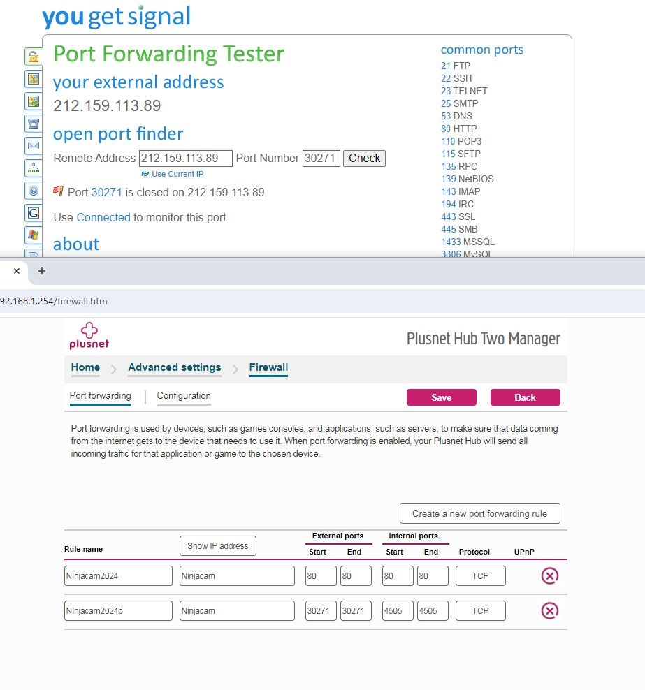

I have tested a port forward rule for port 80 and that seems to work, but I have no success using port 4505.
As a test can you change the external port for the 4505 rule to say 30271 and make a connection using <ip addresses>:30271"
thanks dan.   heres what happened:
Internal viewer now working on 30271.  Phone app didnt need changing to 30271 still works using wifi and ports 80/4505.
Port checker showing 30271 is closed.  Still doesnt connect to DDNS.

Seems like I've got everything working but the ports just arent opening.   Is this something plusnet can support with fixing?

Dan - it isnt working external to my network.  if I'm understanding its because the ports arent open externally.   Its a samsung dvr 443 SRD.   worked for years using dynamic dns on my old router.  doesnt this come down to the port forwarding rules not actually working in my router which is a router issue?  that the router isnt forwarding any ports?

The port forward rules you have set up should work
Can you confirm how the network is setup on the DVR, details of IP address default gateway etc would be handy

@Dan_the_Van I take your point that the dvr might not have correct settings but and maybe I’m missing something but if the port checker is saying the port is closed, surely the set up on the dvr is irrelevant to the status of the port as that’s a router setting?

not to be evasive, I assure you I’ve matched the port numbering and protocols in the dvr.

Yes it was specific to Samsung, I think thats why it wasnt available as an option in hub two sadly.  I didnt understand the second part of your statement about RTSP, but perhaps its relevant to say I signed up for one of the DDNS options hub two is able to accommodate, and router confirms a connection (see below),   But still no viewing access via phone app using that route.

For a test can you create a port forward rule to a different device, can be wireless or wired perhaps the device you are using for posting. My example has a 192.168.10.220 IP, yours would be 192.168.1.?
In the event log you should see
08:27:21, 10 Jun. FWL 'Port Forward configuration added for Server (192.168.10.220) TCP 55555:55555 to TCP 55555:55555 by user'
Once created use this port checker, https://www.yougetsignal.com/tools/open-ports/
For me it will report  Port 55555 is closed on 80.229.xxx.xxx for you it will be 212.xxx.xxx.xxx
The even log should report
08:38:06, 10 Jun. FWL Port Forward Server(192.168.10.220) TCP 55555 accepted a new connection from 198.199.98.246
This will prove an attempt to connect to you network was received from IP Address 198.199.98.246
If this does not happen the the Hub is playing up, I would suggest a factory reset and start again
