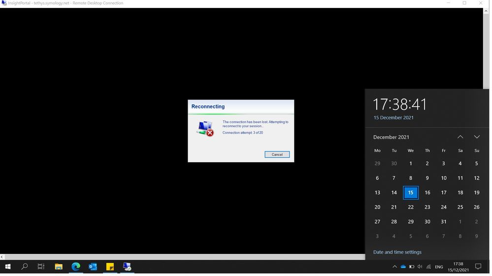

So, guy came this morning and looked at my setup, took lots of photos on his phone of router etc and used my "Plusnet router card" from back of it - without asking - to access the router admin settings and logged on using his laptop, no idea what he did. (Sure he took a photo of this which also has my wi-fi password on). Also reset the router pushing pin into the hole, ran a speedtest and put in a new Openreach Master Socket 5C. Came back up, restarted router (I think, was trying to stay my distance), and ran speedtest again showing it had gone up with the new socket. Said there was nothing else they could do as getting fast speeds (as advertised) and wi-fi was working.
Well, it's dropped a few times again since he went. Just hoping installing the new router tonight will do the trick, but I really doubt it.
Wasn't happy he had access to my router and passwords (which I have since changed), and didn't think he did much other than put new master socket on. Explained I could have it moved upstairs into lounge but Openreach would charge £150 for the pleasure.
Typing this as logged out of my work software when the connection dropped, nothings changed so far...
EDIT: just dropped while bl00dy typing this Sad

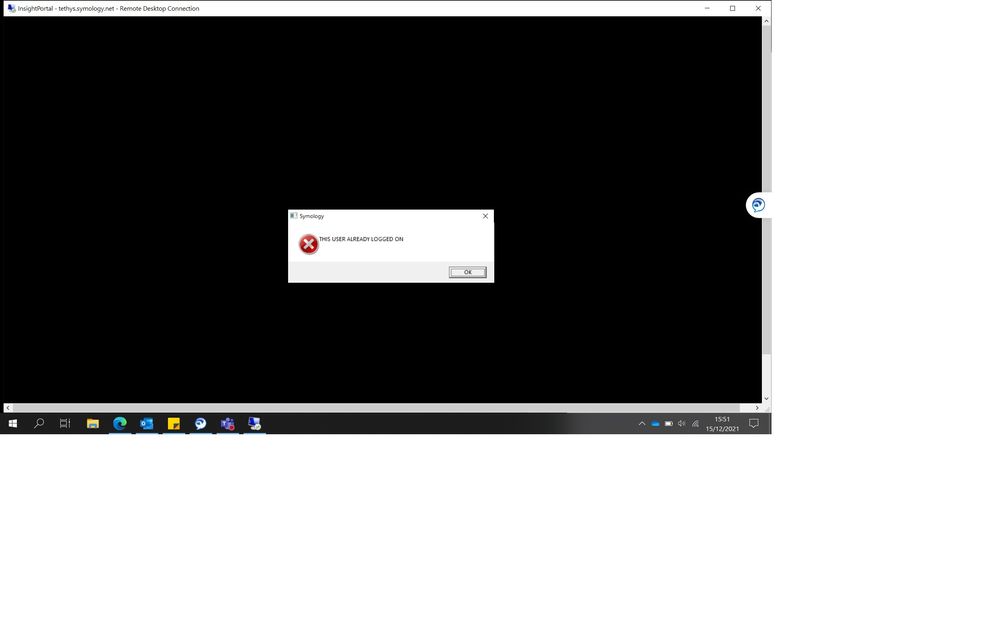

andyt1970
Posts: 302
Thanks: 15
Registered: ‎19-12-2019
Re: Fibre broadband keeps dropping, router light goes orange
Logged out of work for ANOTHER 15 minutes now.
