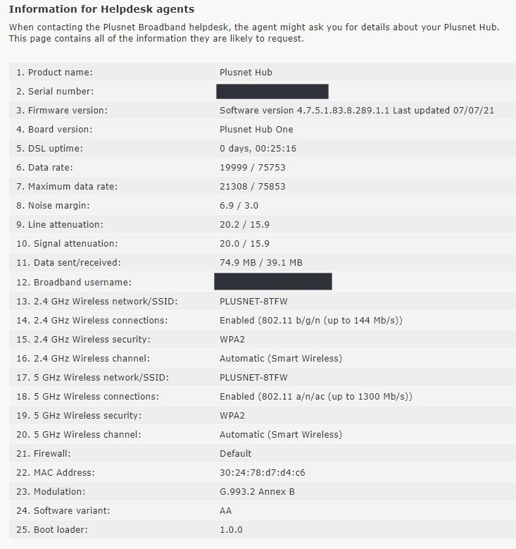

andyt1970
Posts: 302
Thanks: 15
Registered: ‎19-12-2019
Re: Fibre broadband keeps dropping, router light goes orange
Hi all,
Just got disconnected again Sad
And Dan_the_Van - yes that is the master socket downstairs just inside the hall near front door (only socket).

Sounds like the fault ain't fixed then, @andyt1970 - anything in the WAN log at the time?

Yep, you've had another total disconnect - I suggest you get back to PN, although hopefully one of the Help Team will spot this.

Right then, moved router downstairs, plugged micro-filter into TEST socket with grey ADSL cable coming out and into router and telephone extension lead coming out of other hole on micro filter (telephone extension lead runs upstairs as before). Found a TP-Link wi-fi xtender and plugged ethernet cable from back of PC into this (that was in router) and plugged into 6 way surge protection lead, seems fine so far, touch wood. Works laptop using wi-fi signal, but very slow compared to when it was on same desk as desktop PC and router. Will leave it this way in test socket for next 48 hours until someone advises me to plug into normal Master socket switch.
Yes, I shouldn't plug wi-fi extender into 6 way power extension lead but have no choice.
