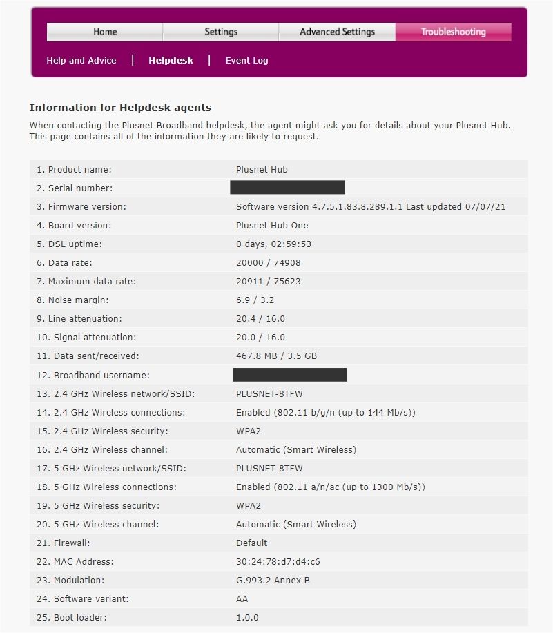

Posts: 24,341
Thanks: 8,646
Fixes: 369
Re: Fibre broadband keeps dropping, router light goes orange
@andyt1970 Apart from your first picture, which suggests the issue is with the Anyconnect service as your other posts don't show any issues, is it possible to post the Hub Help Desk page, and the WAN log from the Hub?

Works laptop lost wi-fi connection and my desktop PC (ethernet) went dead. Blue light went orange (solid) then after a minute went blue and connection restored. Everytime this happens when homeworking on my desktop PC it interrupts the Remote Desktop Connection and I get logged out my works software, then have to wait 15 minutes for it to log me off before I can log on again. What is happening PLEASE?
jab1 - what do you require from the the Hub Help Desk page, and how do I get/post the WAN log please? Thank you for answering by the way.

@andyt1970 A picture paints a thousand words. HubOneTroubleshootingHelpDesk.png
Andy - the Help Desk page in its entirety with personal info redacted, and the WAN log is under the Event Log tab in that picture.

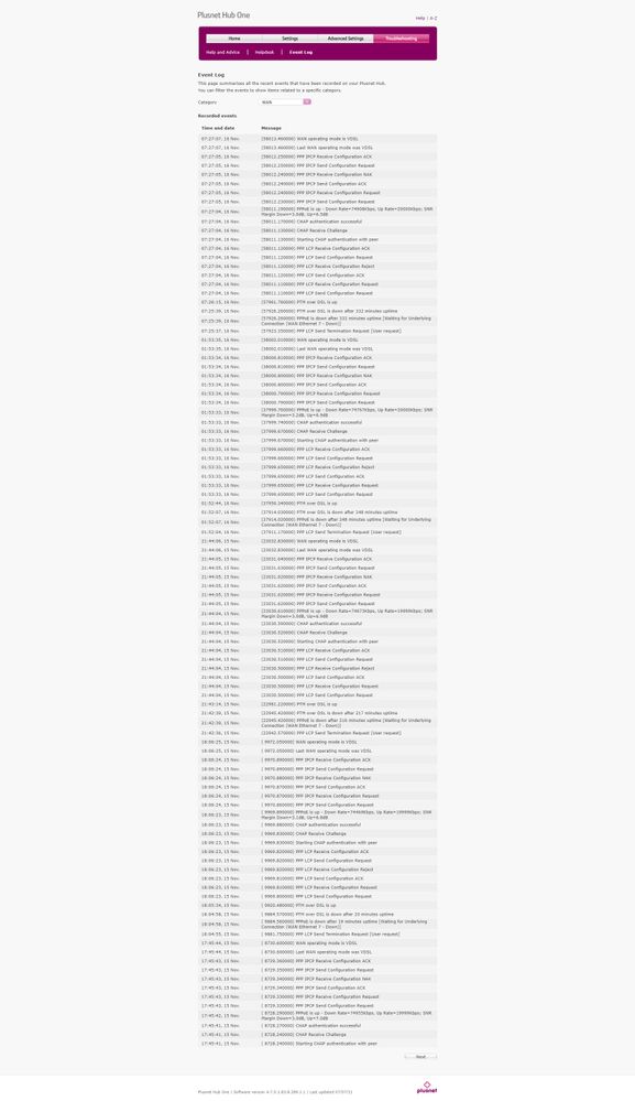

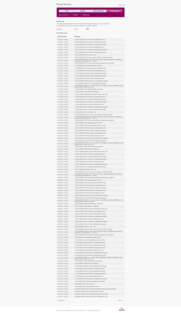

Not sure exactly what info you need but hope this helps?

Andy, thanks for that. The Help desk tab indicates that you are having a lot of disconnections, but unfortunately the WAN logs are too small for me to read. If you still have them, could you post them as attachments, then I may be able to magnify them?

RealAleMadrid
Posts: 3,188
Thanks: 1,806
Fixes: 68
Registered: ‎07-07-2009
@jab1 @andyt1970  I have managed to view them with some magnification, and as jab1 says the line is dropping frequently with the infamous log message "PPP LCP send termination request (User Request)" which isn't a user request at all, just the modem reporting that the line has dropped. Certainly looks like a line fault is in play.
