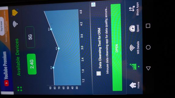

The analyzer speed indicator dial is only 1/2 visible due to an advert that I can't appear to close.
At the Router - At first the needle spins quite far round then stops, then goes up to about 20 then stops again
At the Streamer it's exactly the same
But I can only see 1/2 the dial

pete234356
Posts: 23
Registered: ‎02-12-2023
Re: Extender/booster for Plusnet 2 Hub
Graph shows-
At the Router 2.4G
X-axis 1 =33 (Y-axis)
2=0
4=91
A the Streamer
X1=93.6
x6=44
X8=93.6
5G says Data Not Available

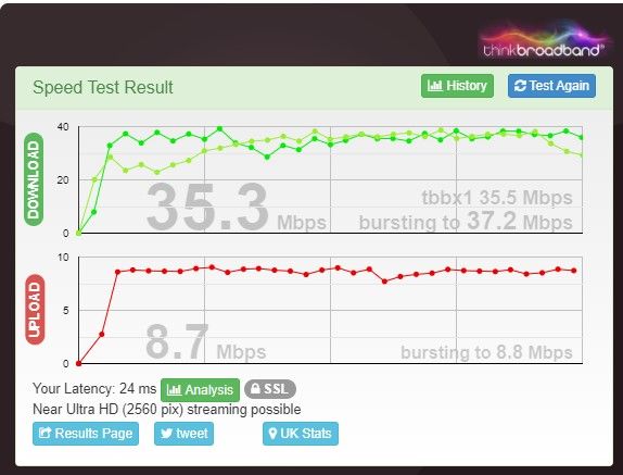

@pete234356
Try this speed tester, there should be no drop outs. There’s no need to fill in the location or review questions https://www.thinkbroadband.com/speedtest

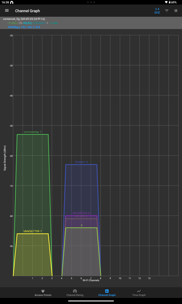

You should see something like that, showing your and adjacent networks. Unless you live in the middle of nowhere...
I get nothing like that
The only graph I see is a simple speed graph - there are no other options
@pete234356
Which app are you using? (Android or iPhone?).
Can you post a picture of the screen that you see?

Android Wifi Analyzer-

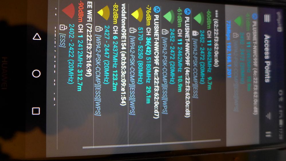

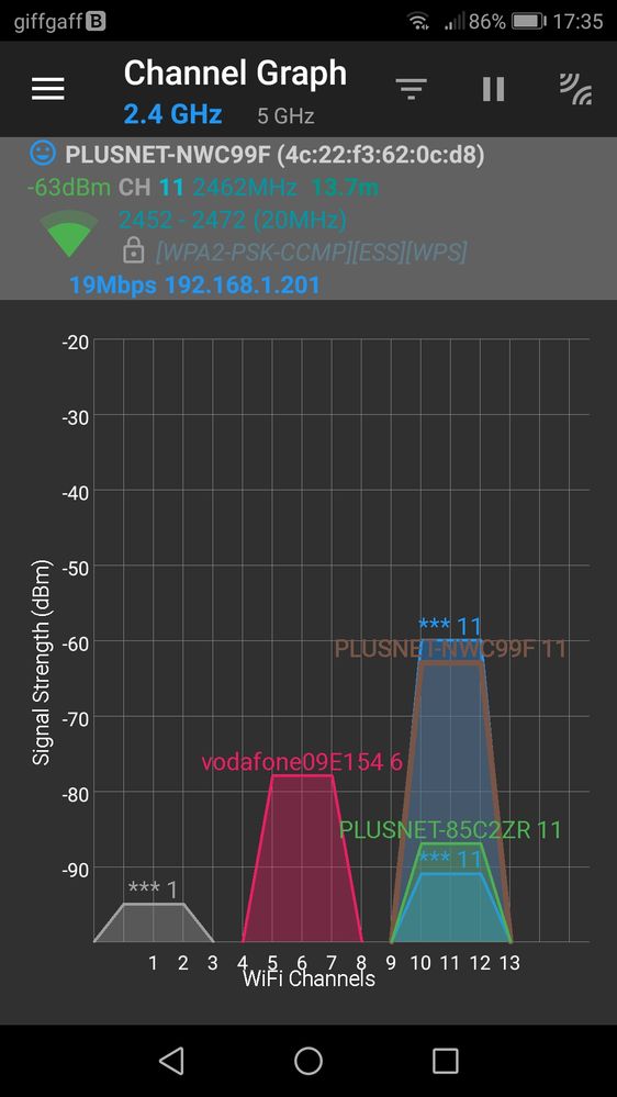

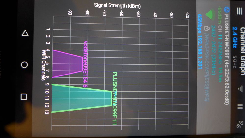

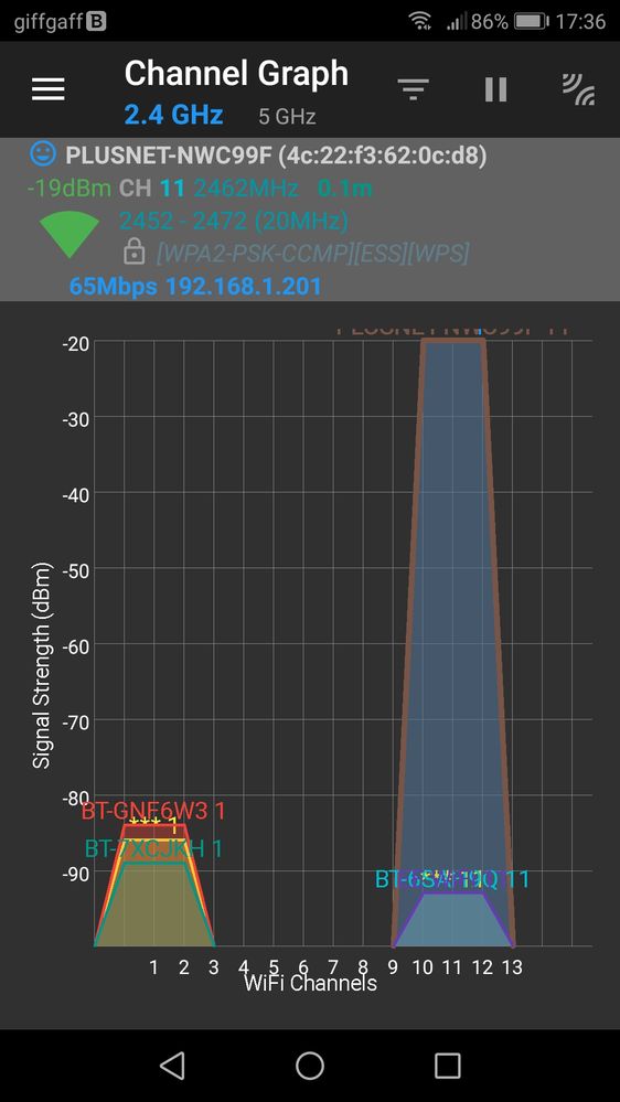

At last I've learned how to do screenshots on my mobile - and find them again later Smiley
Leaving the Channels graph running I see many different routers appearing and disappearing over a couple of minutes with some sharing the same channel as me.
Posts: 20,442
Thanks: 9,277
Fixes: 585
Yes, looks like there's another nearby network on ch 11. There's nothing close on ch 1 so I suggest changing your hub 2 to ch 1
