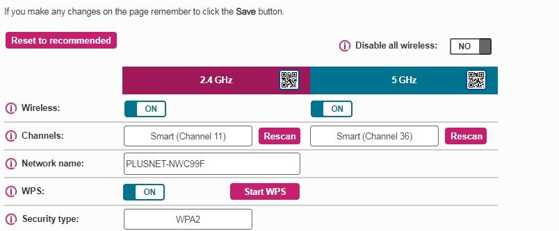

Is this the settings I need to change?
I can see my neighbours wifi as an option on my mobile phone
Re: Extender/booster for Plusnet 2 Hub
Yes.
Did you see other, possibly interfering networks on the WiFi Analyzed app already using channels 11 and 36?
In my experience, "Smart" isn't verysmart - far better to select manually!

The  problem with Smart is that the router sees adjacent network strengths from its location and adjusts the channel accordingly. . The strengths can be very different at the client location

The Analyzer seems to show only my router
So I just change the channels to something else then save?

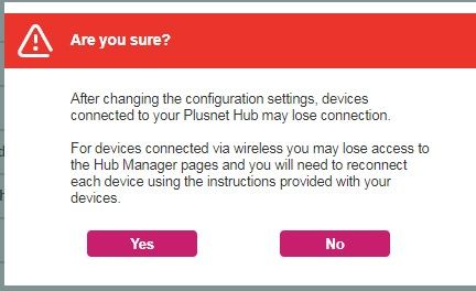

I got this warning come up -
I just wanted to check that everything still work when I save the new settings? as I'll have no idea what to do if it doesn't
