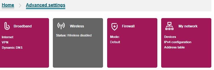

What happens if you turn wireless off completely?
greygit1
Posts: 411
Thanks: 57
Registered: ‎26-06-2023
Re: Entries in a PN Hub2 'router'
This is how it is and has been since well before my orginal question.
