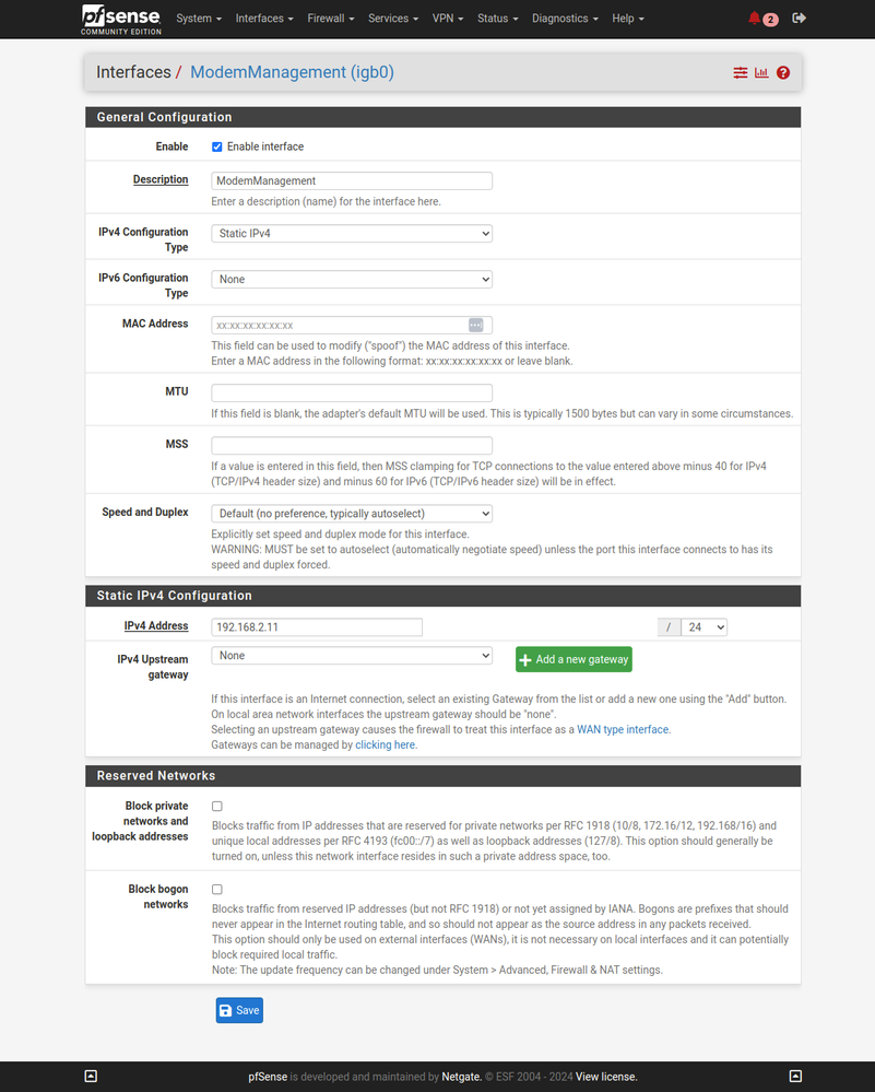

Here are my current settings- to the best of my knowledge match the guide.
ModemManagement Interface
ModemManagement InterfaceModemManagement Interface

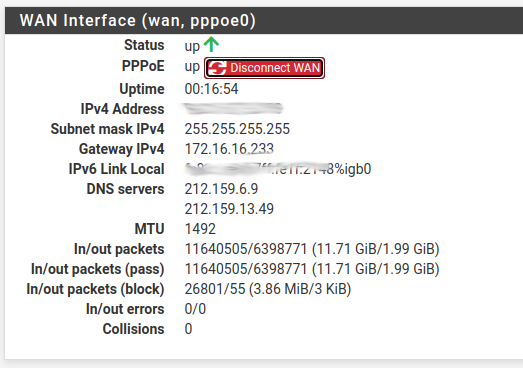

The WAN Interface looks like this
WAN InterfaceWAN InterfaceInterfacesInterfaces
As you can see the PPoE is up but the logs are just being spammed with LCP Down events
I've experiemented with the baby jumbo frames before I reflashed the Vigor 130 with the alternative ECI firmware which limits to 1500 MTU and that didn't really seem to help.
Anything you can spot?

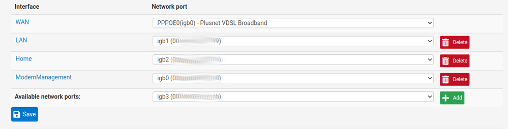

@oakteryx that log is definitely showing as from the opt3 interface. What have you got the opt3 interface configured as ?
This might help https://kb.protectli.com/kb/pfsense-optional-port-configuration/
but I've just run a TCP dump on each of the interfaces and the WAN Interface is the only one with PPoE traffic
Tcpdump possibly wont show any pppoe traffic, I suspect whatever it is, its not getting past the PADI broadcast

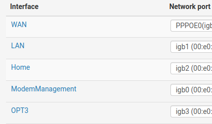

It is odd- other than this log entry I can't see any reference to OPT3 on any of interfaces.  As far as I can see I don't have an OPT3 interface. Possibly some 'ghost' config??
I will remove all of my interfaces and re-add them this evening while nobody is online.

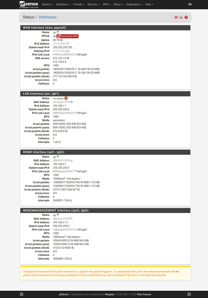

Re: Draytek Vigor 130 + PFSense constantly reconnecting via PPoE
Try selecting "Status" in the top menu bar, and selecting "Interfaces" from the drop down list.
If you then scroll down that screen, looking at the black title bar for each interface, is there any clue to what OPT3 is ?
When I go to add a new interface- it wants to call the next one I add OPT3- again to me suggesting I don't currently have an  OPT3
