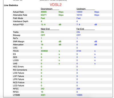

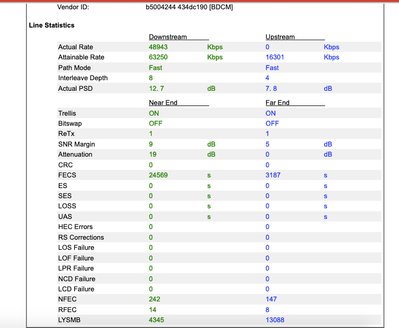

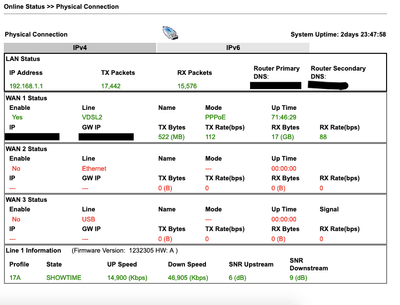

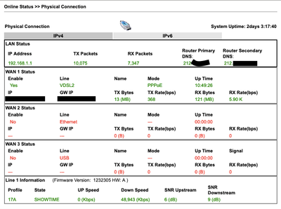

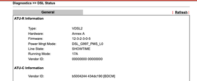

The DSL light shows orange fixed/steady orange colour when training, and changes to green but flashes(blinks) slowly and then quicker and the slowly; but never locks in to a fixed state. The connection dashboard shows 17A Showtime and the internet connection works. But ? except when data is being transmitted, should the DSL Led be solid fixed green ?
When checking the router Syslog, the router seems to be cycling through to Showtime constantly. (Every 29 secs).

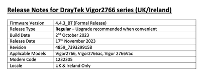

As to the repeated entries in the log, It looks like some form of debug level is set. I'd check first that you have the latest firmware. Draytek also have different versions of the modem code for various DSL types. Check in the release notes the appropriate one for Openreach VDSL.

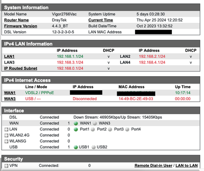

On the matter of the Firmware it appears to be up to date.

Re the repeating Showtime in the Syslog; is this normal ?  if not what could reasons be ?
I wouldnt expect those repeated logs. The ADSL status does not appear to be changing (its always SHOWTIME) so my conclusion is that its possibly some debug left in that version of firmware. I would suggest you ask Draytek why they are being produced

As far as the connection on the Draytek is concerned, the Dashboard has an "Up Time". On the assumption that this gives many days that's how long the VDSL session has been up. If the repeated "showtime" in the logs were an issue you would be having connection drops.
