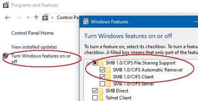

Have you installed SMB 1.0 client, as it is disabled by default in 'new' installs of Windows 10 ?
jamesda
Posts: 4
Registered: ‎19-01-2020
Re: Connecting to a USB Drive in the Router from Windows 10
Thanks, yes, I have those all boxes ticked (including the server one).
