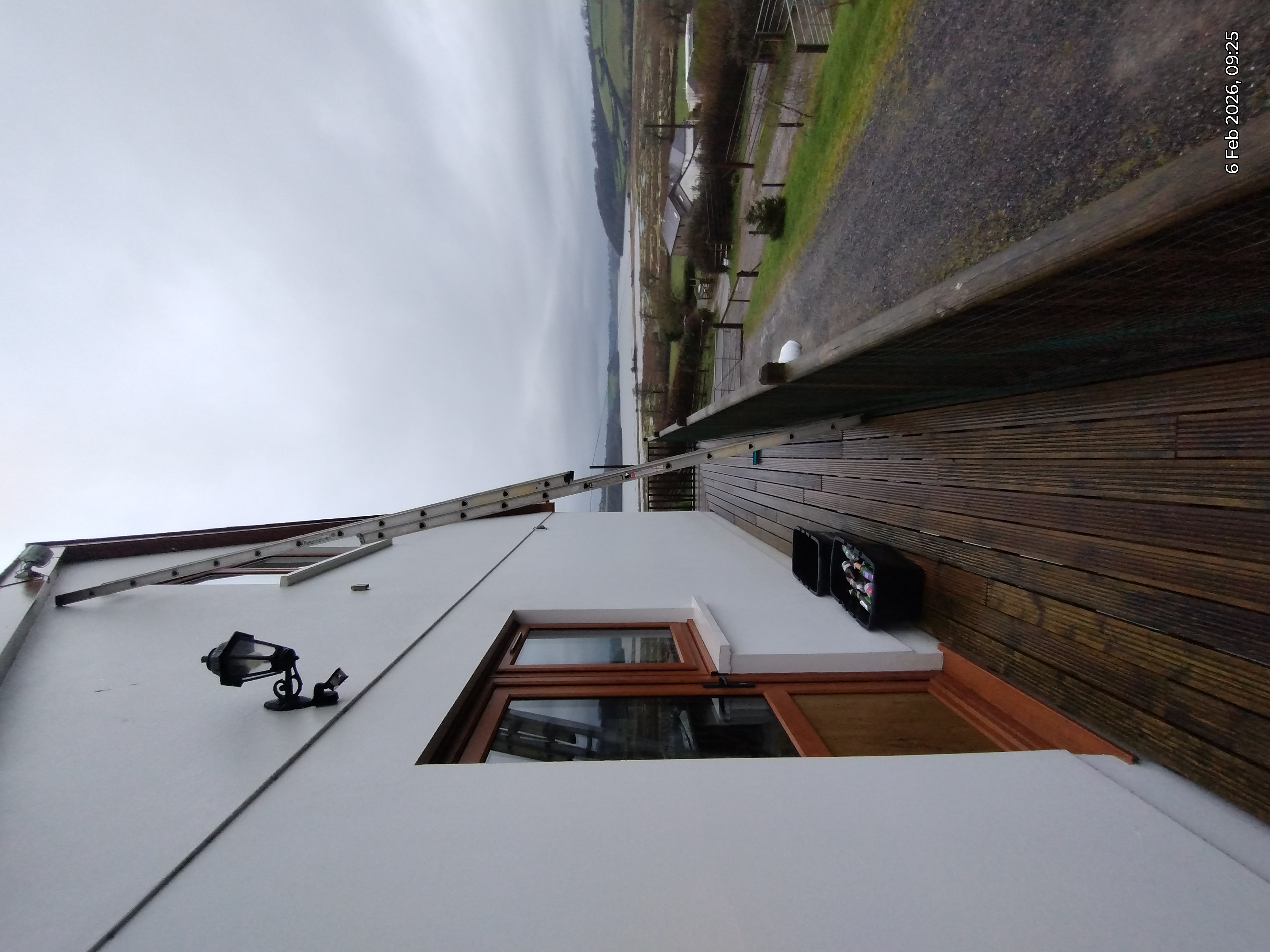

The attached shows what I was doing earlier. I removed the two ethernet cables from the 4G modem/router and connected the cables together. I was expecting a gigabit limit in the office as all interim devices now have the capability. The new PN Hub Two router does not show the cable speeds but the old Hub One shows the incoming port as only 100 Mb/s. I suspect that is due to it being the oldest cable we have - a basic Cat5. I think I shall attempt to run what is left of the Cat6 before my wife gets home!

I tell a lie about the cable - it is a Cat5e. I tried swapping the ports on the router and the slower speed goes with the cable. The run is only about 12m so nowhere near the 100m limit.
I shall use my newly acquired Parkside cable tester on it! (No good on speeds but it will tell me if I have put a cable into the wrong place.)

Fairplay to the Parkside tester, it detected that two UTP pairs were shorted. That did not affect 100 Base-T but it knackered the gigabit!
Much swearing up a ladder in the rain - my success rate wiring those damn plugs isn't good: one decent plug from three attempts - but the thing flies now with around 933 Mb/s!
