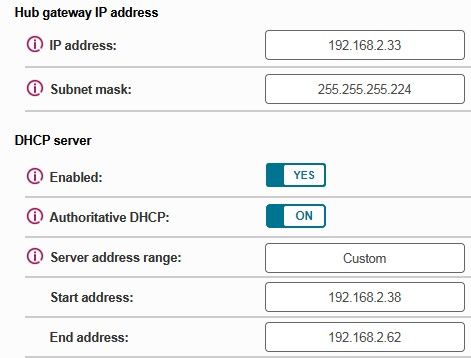

@germarsh wrote:
I assume that I can change the IP address pool / range of its DHCP server and the IP address of the router itself.
Example
Depending on how much you know about subnetting may give an answer regarding devices with static IP addresses in the above network (there are some devices with static addresses).

Thank you, Grumble. Was there supposed to be some diagram with "Example"? I just get a pale yellow triangle symbol.

You should now be able to view the image.

That functionality I can work with. I think that the subnet mask would only allow 32 addresses be allocated by DHCP.

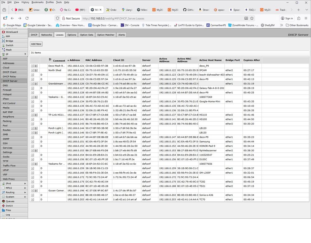

Here are the leases this morning. The devices with "D" in the second column are dynamic whereas the others are static. The manually configured devices, including some Shelly sensors, aren't listed as they are not in the DHCP range.

By default the Hub two network is 192.168.1.0/24 (class C).The default DHCP pool address is 192.168.1.64 to 192.168.1.253
with the Hub Two IP address being 192.168.1.254. You can use your preferred network ranges, but avoid 10.x.x.x ranges.
